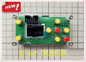

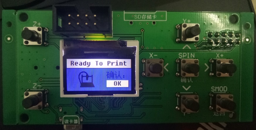

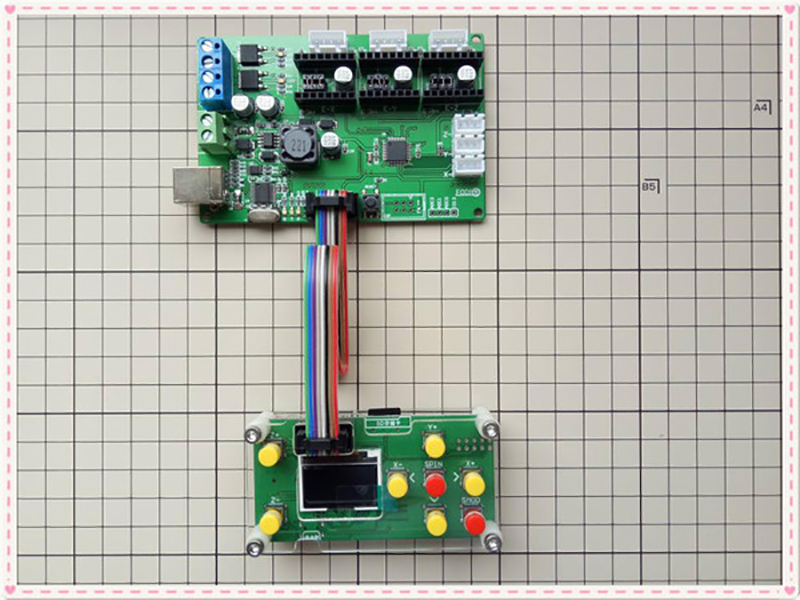

Тем временем сумеречный китайский гений породил автономный пульт для GRBL(~1 600руб). Вот тут - в комплекте с оригинальным GRBL-контроллером (~2 800руб)
HTB1ygmIQVXXXXX7XpXXq6xXFXXXR.jpg (7215 просмотров) <a class='original' href='./download/file.php?id=116699&sid=a27477d951fb4bb4efeae14fb75ad87a&mode=view' target=_blank>Загрузить оригинал (264.41 КБ)</a>
Поскольку ссылки на Али имеют тенденцию быстро протухать, придется скопировать информацию со страницы товара: (для просмотра содержимого нажмите на ссылку)
Free shipping New GRBL off-line working controller LCD screen+3axis control board for laser engraving machine wood router.
Packing include:
LCD screen GRBL controller *1
3axis control board*1
GRBL controller Function:
1. Manually control: manually adjust X, Y, Z axis location as engraving starting point, manually open or close spindle, manully open or close cooling fan
2. File engraving: after off-line controller save file, it can connect the GRBL control board and process engraving, no need to connect PC computer
3. Save file: after the off-line controller connect PC, it will be recognized as USB, large capacity storage device, can access engraving file directly.
HTB1AD1cQVXXXXcxXVXXq6xXFXXXL.jpg (7215 просмотров) <a class='original' href='./download/file.php?id=116698&sid=a27477d951fb4bb4efeae14fb75ad87a&mode=view' target=_blank>Загрузить оригинал (292.08 КБ)</a>

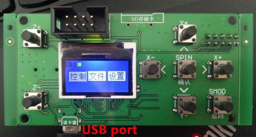

Home page
HTB1ri9dQVXXXXcgXVXXq6xXFXXXU.jpg (7215 просмотров) <a class='original' href='./download/file.php?id=116700&sid=a27477d951fb4bb4efeae14fb75ad87a&mode=view' target=_blank>Загрузить оригинал (117.42 КБ)</a>
SD shows it is SD card condition, turn on power supply after insert SD card, otherwise, it won't work. SD card capacity 4G could be recognized.
Press X- or X+ button to switch
Control:Press confirmation button to access manually controlling page
File:Press confirmation button to access file page
Set:Press confirmation button to access setting page

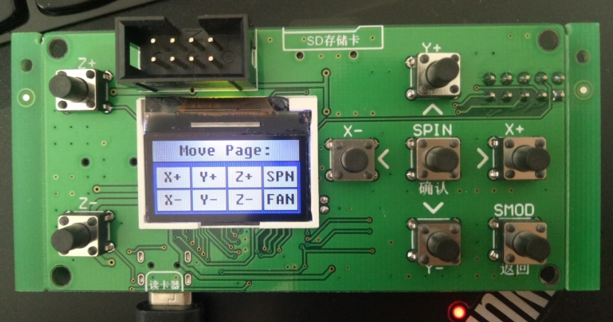

Manually controlling page:

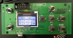

HTB1hYdHRpXXXXcaXpXXq6xXFXXXp.jpg (7215 просмотров) <a class='original' href='./download/file.php?id=116701&sid=a27477d951fb4bb4efeae14fb75ad87a&mode=view' target=_blank>Загрузить оригинал (116.25 КБ)</a>
On the off-line controller, buttons control corresponding actions. SPN is spindle controlling,should press SPIN. Fan is fan controlling, should press SMOD. Note: To exit this page, should press back button longly. after exit, save the current location as engraving starting point X0Y0Z0

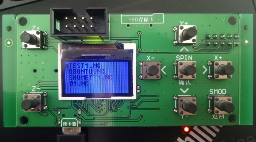

File traversal page:
HTB1r3pdRpXXXXa5aXXXq6xXFXXX6.jpg (7215 просмотров) <a class='original' href='./download/file.php?id=116702&sid=a27477d951fb4bb4efeae14fb75ad87a&mode=view' target=_blank>Загрузить оригинал (114.42 КБ)</a>
Note: system can recognize max 100 available files one time (***.TXT***.txt***. NC***.nc***.CNC. ***.cnc***.TAP***.tap could be recognized), not support files with long name. Press Y+ or Y- to choose files need to be engraved, press confirmation button to access engraving page.
HTB1Em4zRpXXXXawXFXXq6xXFXXX3.jpg (7215 просмотров) <a class='original' href='./download/file.php?id=116704&sid=a27477d951fb4bb4efeae14fb75ad87a&mode=view' target=_blank>Загрузить оригинал (105.49 КБ)</a>
Press ok to start engraving. If you want to stop during engraving, press back button longly, then back to the file selection page(machine will not stop at once, as GRBL controller has already saved a part of G code, will stop after carry out completely).
Setting Page:

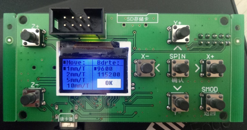

HTB1l3XURpXXXXaZXXXXq6xXFXXXX.jpg (7215 просмотров) <a class='original' href='./download/file.php?id=116703&sid=a27477d951fb4bb4efeae14fb75ad87a&mode=view' target=_blank>Загрузить оригинал (119 КБ)</a>
The left words show the machine moving distances every time you press the button on the condition of manually controlling, press Y+ or Y- to choose, default 1mm each time.
Press X- or X+ for switchover setting. The right words show Communication baud rate setting, default 9600. After setting, press confirmation button to save, then press back button to exit setting page. Note: the setting parameters can not be saved on the condition of electricity outage, it will be default value when turn on next time.
Если кратенько - дивайс может работать в трех режимах:
1.Ручного управления,
2.Исполнения УП с флэшки,
3.Прикидываться флэшкой при подключении к компу для копирования файла УП.
"Мамка" девайса имеет признаки GRBL - сама ATmega328, вторичный DC-DC (возможно 24-5В), места для установки степ-стиков, ключевые транзисторы включения шпинделя/лазера/насоса. Только смущает меня 8-проводной шлейф от пульта к контроллеру. Хватило бы четырех (Rx, Tx, Vcc и GND). Не пользуют ли они допиленный протокол/прошивку? Подойдет ли пультик к обычному GRBL-контроллеру? В общем, чудной зверек. Интересно было бы в руках потискать.
